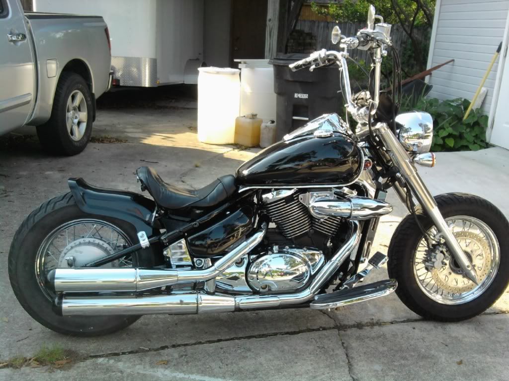

Yes you can. No need to buy any cables, just re-route. and here is what it will look like

Good looking bike, Iron Cowboy.

Iron_Cowboy wrote:Yes you can. No need to buy any cables, just re-route. and here is what it will look like
NICE!

LOVE the rear fender Iron Cowboy!
Great job! [CLAP]
Very clever reuse of the rear fender and stock pipes, too. Very cool!

Rob, you are right - the stock pipes actually look good there. Very nice ride.

Thanks, actually that is the rear section of the front fender. But I destroyed it when I put a new tire on it. Should have allowed a little more clearence. :oops: I have a metal fender that I am going to be modding to fit.
